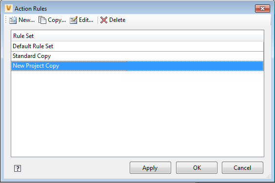

  1. Click the Master Menu on the toolbar and select Action Rules to open the Action Rules dialog.
  2. Perform one of the following steps:
    • Click New to create a new rule set.
    • Select an existing rule set and click Edit.
    • Select an existing rule set and click Copy. A new rule set is created with the same conditions and settings as the source rule set. Select the copy and click Edit to make changes.
