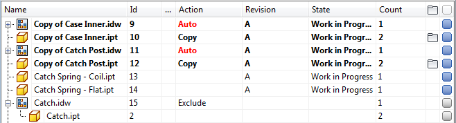

The Main View Grid
The main Copy Design view shows the name of the files available for copy, the file identification number, the action that will be performed on the file, the revision and state of the file, and how many instances (Count) of the file occur within the current list.
Tip: By default, reference file names are set to the destination file name when an action is assigned. You can view the Numbering Panel to identify files by original name or add File Name (Historical) to the main view.
You can also manage copy actions and customize the view from the main view.

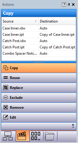

Actions
The Actions Panel lets you review which operations are assigned to be performed on files in the main view.
Once you have configured the files in the main view, you can use the Actions Panel to filter the files based on their assigned operation. Assigned operations include copied, reused, replaced, excluded, or edited.
Use the Actions Panel to verify the copy design configuration in the main view and to make any necessary changes.
Note: You can also set action operations by dragging and dropping files from the main grid onto the desired operation button in the Actions Panel.
See Copy Design–Actions for more information.
