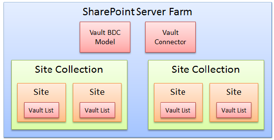

- It is permissible to deploy to multiple site collections, as demonstrated by this image.
