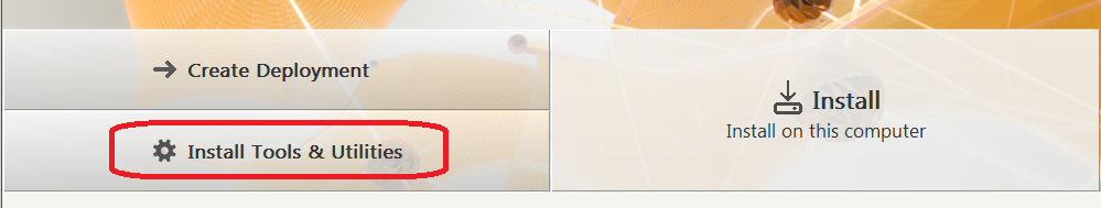

  1. Launch the Vault installation software.
  2. Click Install Tools & Utilities.
  3. Accept the License and Services Agreement, and click Next.
  4. Check the boxes for components you want to install (Vault Data Standard, Vault Data Standard for AutoCAD, or Vault Data Standard for Inventor).
  5. Click Install.
