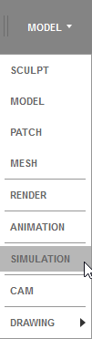

Fusion 360 has various capabilities. Different capabilities are divided into Workspaces, such as CAM and Simulation. The Launcher is accessed through the Simulation workspace. The simulation workspace has a modeling environment called Simplify. The Simplify environment contains the simulation launchers.
