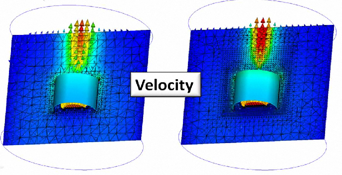

Position the region around critical components and in areas where large flow and temperature gradients are expected.
Example
A refinement region is built around a fixture. The influence on the velocity near the fixture and in the thermal plume is significant:
