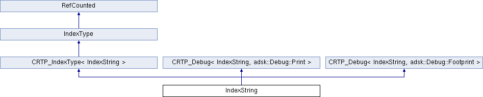

Index type which uses a String for the index mapping.
This is a more general type of indexing that can only be used in mapping mode since it doesn't make sense to define "all strings between two strings".
