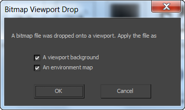

To assign a viewport background by dragging and dropping:
- Browse images in Windows Explorer or in another graphics-browsing application.
- Select a thumbnail of the bitmap with your mouse and drag it onto an empty area of a viewport.
Do not drop the map onto an object: This creates a material instead of assigning a background.
3ds Max opens the Bitmap Viewport Drop dialog:
- A viewport background
- When on, puts the bitmap into the viewport as a background.
- An environment map
- When on, includes the bitmap when you render the viewport.
- Click OK.
