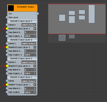

The Compositor View Navigator displays a miniature version of Compositor View that you can use to easily navigate around complex node layouts.
Compositor View with Navigator in top-right corner
The Compositor View Navigator appears in the top-right corner of the interface. Nodes represented as solid gray blocks and the currently visible portion is outlined by a red rectangle.
