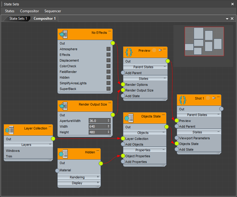

Compositor View is an optional panel in the State Sets interface that displays a schematic of states that can output rendered images (not including the Objects state). Actions that can be performed include rewiring components, color correction, linking with external compositors such as Adobe After Effects, and more.
Compositor View panel with nodes shown in the active view

Using a node-based workflow, you can set specific properties for each state. This workflow operates in parallel to the record-based workflow where you set the parameters to change directly in the 3ds Max UI. A node-based setup provides several advantages over the recording method, including:
- The ability to directly set parameters for states and instance between them;
- A visualization of what parameters have already been set for individual states, as well as for parent states and instanced parameters;
- An easier process for adding and removing state parameters.

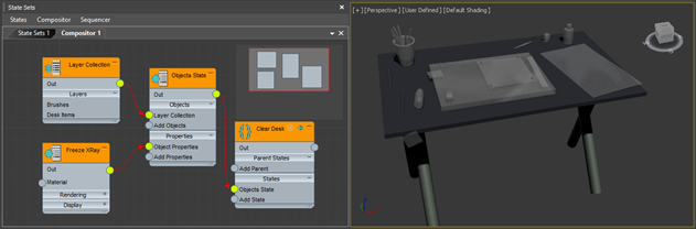

There are currently approximately thirty nodes available for creation. While these nodes focus on render pass functions, they are not limited to that purpose. The example shown below, for instance, is a node-based workflow used to Freeze and XRay items on top of a desk. By using similar techniques, Compositor View can be very helpful for general scene management.
