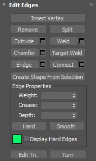

This topic provides detailed information on the edge-specific rollout: Edit Edges. The remaining rollouts are described in their own topics.
This rollout includes commands specific to edge editing.
