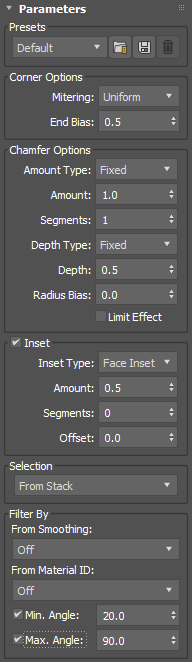

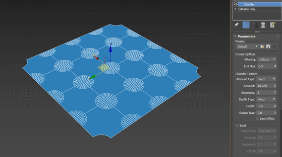

Parameters rollout
- Presets
- From the drop-down menu, choose from the list of preset chamfer settings.
- Click
to load a selected preset.
- Click
to save the current stack as a preset. When saving a preset, you must specify a name and an optional tooltip to show while hovering over the name in the list.
- Click
to delete the selected preset. A dialog will appear to confirm the action.
You can also right-click the drop-down menu and choose Set as default to apply the current settings as default.

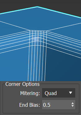

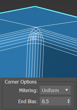

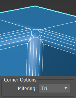

Corner Options group
- Mitering
- Sets the method for joining corners when multiple edges connect to the same vertex:
- End Bias (Not supported for Tri mitered corners)
- Controls the ends of chamfers that do not involve a corner, with the ability to move the end point towards the next edge. A value of 1.0 moves the end of the chamfer to the first vertex of the next edge, while a value of 0.0 ends the chamfer.
End bias value adjusted from 0 to 1.0 and back again
Chamfer Options group
- Amount Type (Uniform, Patch, and Radial mitered corners only)
- Sets the amount type:
- Fixed: the chamfer amount doesn't grow or shrink based on the number of edges connecting to a point.
By Weight: uses the Weight channel data from the mesh to drive the amount of chamfer. Weight can be adjusted in the Edge Properties group of Editable Poly or the Edit Poly modifier.
- By Crease Weight: uses the Crease Weight channel data from the mesh to drive the amount of chamfer. Crease weight can be adjusted in the Edge Properties group of Editable Poly or the Edit Poly modifier.
Tip: Use Crease Weight to interpolate the weight between the vertices, creating a blend along the edge of the weight. Use By Weight to maintain a consistent weight along the edge, interpolating the weight within the mitered corners.
Increasing chamfer amount with the By Crease Weight option enabled
- Legacy: Uses the legacy algorithm combining Quad Chamfer and Quad Intersection. This option remains in order to support legacy files, however it is not recommended for use with new models.
- Amount
- Sets the width of the chamfer in distance units. Default=1.0.

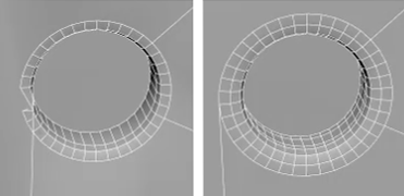

- Limit Effect
- When on, Helps prevent overshooting of edges by restricting the distance chamfered sub-objects can travel towards each other. In other words, when Limit Effect is on, increasing the Amount setting past a certain value (based on existing geometry) has no effect.
Note: When the Mitering option is set to Tri mitered corners, Limit Effect is always applied. This setting will remain in effect when changing from Tri to other mitered corners, so it must be turned off explicitly.
Left: original cylinder; Top right: Chamfered with Amount=8, Limit Effect off; Bottom right: Chamfered with Amount=8, Limit Effect on

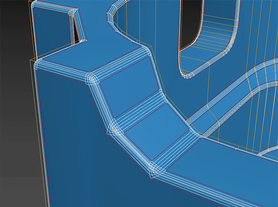

Inset group
Mesh issue corrected by using Face Inset (right)
- Inset
- Enables a face inset along the edges of the chamfer based on the criteria currently generating the chamfer.
