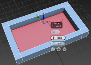

- Go to the Polygon sub-object level, select the inside polygon on the top of the box, and extrude it inward about 10 units. Exit Extrude mode.

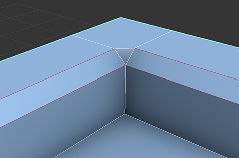

- Under Corner Options, set Mitering to Tri, which replicates the legacy Standard option of previous versions.
Note that the polygons at the corners are now triangles. Triangular polygons can lead to unpredictable results when modeling, so it's better to work with quads whenever possible.

- To compare this result with the legacy chamfer method, set Mitering back to Tri for a moment.
As you can see, the chamfered area is flat again, and there is no deformation because neither the Depth setting nor the Tension setting are available with Tri mitering.

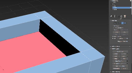

- Select Editable Poly again and click on the Polygon button.
- Turn off Show End Result (

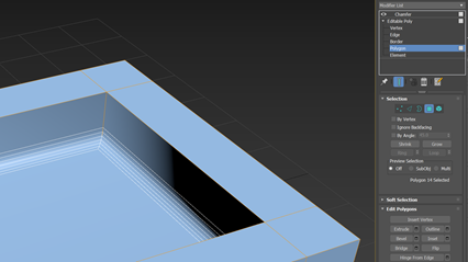

) to better see your selection. Then select one of the inside walls of the box and hold Shift and click the face next to it. This will select the entire loop of faces.
- Go back to the Chamfer modifier and set Selection to Selected Faces Border.
A border comprises only edges on the
perimeter of each contiguous polygon selection. So with the Selected Faces Border option, interior edges such as the vertical corners are not chamfered.
