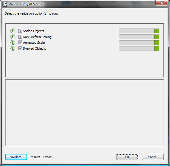

Validate Scene Before Export
To make sure the scene contains a valid simulation, use the Validate MassFX Scene command on the Utilities submenu or the Tools panel. Doing so opens the Validate MassFX Scene dialog:
Use the dialog to perform validation tests to ensure that the MassFX scene exports properly without errors. The validation options are as follows:
- Scaled Objects
- Finds any graphical meshes used by MassFX that have scaling other than 100%/100%/100% applied.
- Non-Uniform Scaling
- Finds any graphical meshes used by MassFX that have differing scales per axis.
- Animated Scale
- Find any graphical meshes used by MassFX whose scale has been animated.
- Skewed Objects
- Finds any graphical meshes used by MassFX that have been scaled along axes other than the primary ones.
Choose the tests to perform by turning on the corresponding checkboxes, then click the Validate button. The tests are performed one at a time, during which the progress bar for each test updates. When the validation finishes, it updates the result icon at the end of the progress bar with one of three colors:
- Valid is indicated by a green icon.
- Fail is indicated by a red icon.
- Note is indicated by a yellow icon.
When a validation result is either Fail or Note, the result is be shown at the bottom box in the window.
