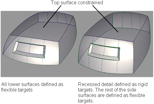

Add Flexible Targets
Flexible targets are surfaces, curves, or meshes that can have their shapes changed by applying transformations to the rig.
To add flexible targets, click this icon and select the geometry to assign as targets, then click Accept Targets. To remove targets, choose the Remove from Rig tool in the toolbox.
Add Rigid Targets
Rigid targets are surfaces, meshes, or curves. They transform (translate and/or rotate) along with the modification, but keep their shape; that is, the targets do not scale or shear.
To add rigid targets, click the icon and select the geometry, then click Accept Targets. To remove targets, choose the Remove from Rig tool in the toolbox.
Use the on a target to open a pop-up menu that enables you to lock the movement direction for the rigid targets.
If Rigid is selected, the target is free to rotate and translate in all directions. Rigid Translate only allows translation to occur: the target is not rotated. Further restrictions can be used with the X, Y, and Z constraints, which allow translation to occur in only one specific world-space axis direction (note: this does not respect construction planes). You can also change the type of target from Rigid to Flexible, or vice-versa.

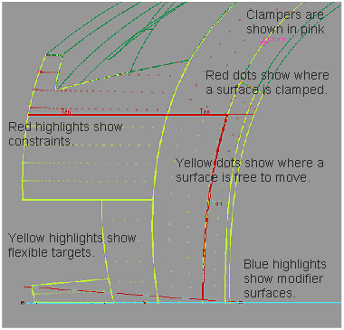

Add Constraints
Constraints define a region of the model that should not be modified, and also delimit the range of modification. The continuity along the constraint can be fixed as positional or tangential. Using the to click a constraint opens a pop-up menu to change the continuity quality of the constraints. The default is for the constraints to be tangentially continuous.
Add Clampers
Clampers can help the software recognize regions of the model that should not be modified. These regions are usually defined by the constraints, but in some cases, the help of a clamper or clampers is needed. These regions can be identified with the help of the green and red dots that appear when setting constraints. These dots appear when Clamp Visualization is checked in the option box.
The region with green points is the region that is free to be modified. The region with red points is fixed, and will not change. To improve the visualization temporarily, pick a dot with the middle mouse button to make the colors more vivid.
Remove from Rig
Choose this tool to remove targets, modifiers, constraints, or clampers from the rig. You can pick constraints, modifiers, or targets, and clampers. The geometry picked for removal is highlighted in yellow. To confirm the removal, click the Remove Selected button in the lower right corner of the view. To cancel the operation, click Cancel.

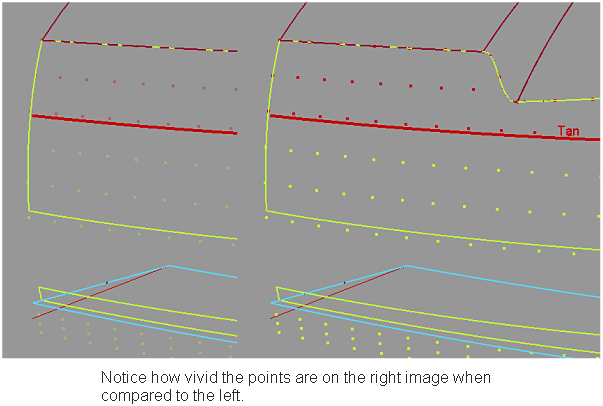

Draw Modifier Sampling
If this box is checked, this value enables you to visualize the sampling of the modifiers and constraints.
Note:
Eight tangent constraint points also appear at the corners of a box twice the size of the bounding box for the rig. These widely spaced tangent constraints help prevent exaggerated deformations for cases where there are few or no constraints.
Draw Clamp Visualization
If this box is checked, the Transformer Rig tool draws a visualization to improve understanding of the clamp regions.
