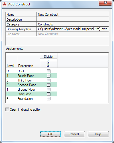

Use this procedure to create a new construct within a project.
Construct.
| If you want to… | Then… |
| name the new construct | enter a name. If the project number is used as a prefix for project file names, you do not need to enter the prefix here. The complete name with prefix is displayed under File Name. |
| enter a description for the construct | click the setting for Description, enter a description of the construct, and click OK. |
| change the category of the construct | select a category from the Category list. By default, the category you chose in step 3 is suggested. |
| select a different template file | click |
| assign the construct to a level and a division | select the correct level and division in the assignments table. Select the desired level row and the division column, and check the appropriate box. Note: You should check only one level and division. Multiple levels and divisions create spanning constructs.
