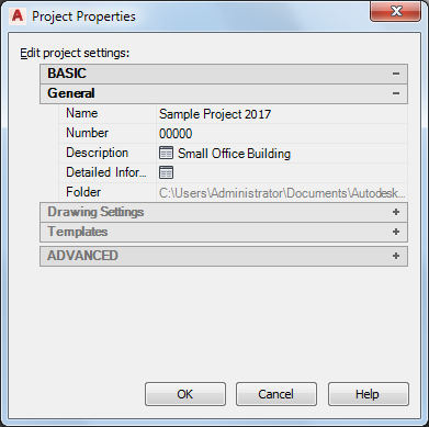

Use this procedure to define or change basic properties for a project. Basic properties are divided into 3 categories:
. The Project Properties dialog box is displayed.
| Property | Description |
| Name | The project name is defined when you create the project. If you change the name here, only the name displayed in Project Browser and Project Navigator is changed; the APJ file and the project folder in Windows Explorer retain the original name. |
| Number | The project number is defined when you create the project. You can enter a new number here. Note: Under Drawing Settings, you can specify that the project number is added as a prefix to each project drawing created in the project. If you change the project number during the project life cycle, the existing file names will be changed and repathed.  |
| Description | To add a description or change the current one, click  , enter the desired text, and click OK. |
| Detailed Information | To attach user-defined information to a project, such as project data and site description, click  . |
| Folder | This path is read only and identifies where the project is located. |
