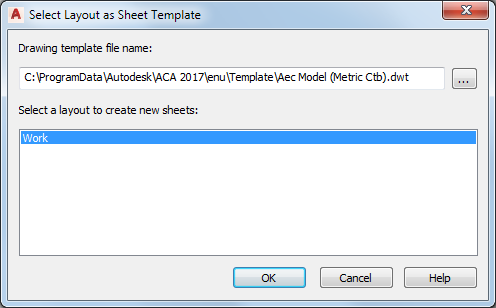

-  To define a default template for new sheets, click the setting for Sheet creation template.
- Click  to browse for a drawing (DWG) or template (DWT) file, and click Open. to browse for a drawing (DWG) or template (DWT) file, and click Open.
- Select the default layout you want to use to create new sheets. Then, click OK.
