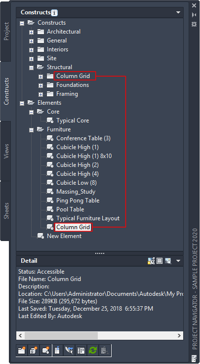

You may create a construct, and then realize that this is actually a repeating element. For example, you might create a column grid and then decide to use it on another floor. You can easily convert the construct to an element and reference it into multiple constructs.
Note:
- When you convert a construct to an element, the level and division information is lost. Should you later convert the element back to a construct, you must reassign to a level and division.
- Do not drag a construct into the Elements folder within Windows Explorer. This will result in inconsistent project data.
- On the Quick Access toolbar, click Project Navigator
- On the Constructs tab, locate the construct to convert to an element, and drag it into the Elements category or one of its subcategories.
Note: If you want to convert the element back to a construct, drag the element to the Constructs category.
- Specify the element properties.
