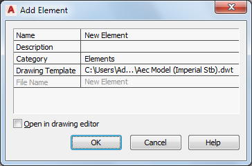

Use this procedure to create an element.
.  Element.
 Element.  . (You then specify the category in the dialog box.)
| If you want to… | Then… |
| name the new element | enter a name. If the project number is used as a prefix for project file names, you do not need to enter the prefix here. The complete name with prefix is displayed under File Name. |
| add a description for the element | click the setting for Description, enter a description of the element, and click OK. |
| change the category of the element | select a category from the Category list. By default, the category you chose in step 3 is suggested. |
| select a different template file | click  , and browse for a new template. By default, the default template for elements set in the project is used. |
