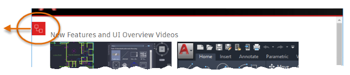

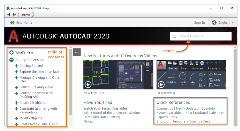

There are three primary areas in the Help Home page:
There are also separate lists for system variables, Express Tools, and various keys, including the Function keys, F1 - F12.

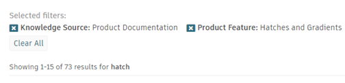

The type-ahead feature is currently available for a small but growing list of AutoCAD terms. Go ahead and finish typing hatch.

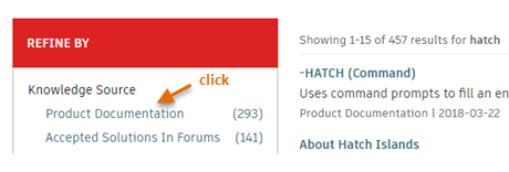

This action reduces the knowledge sources to one: Product Documentation. This action reduces the number of results to 293.

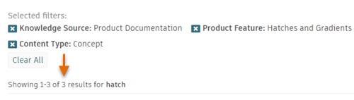

The selected filters can be removed individually from the list, or cleared completely if you want to replace one or more of the filters. While it takes several clicks to specify what you're looking for, it's much better than scanning through a lot of topics that aren't what you're looking for.

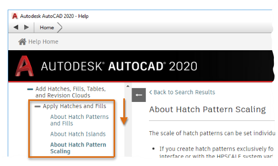

We've now reached our goal of locating the topic about scaling hatches, but let's explore a little further to discover several additional features.

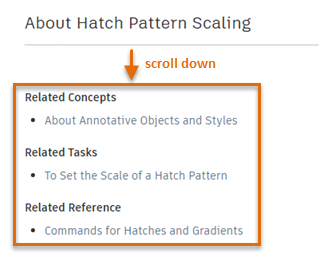

These are three general types of information: conceptual descriptions, stepped tasks, and links to related commands and system variables.
Notice that the table of contents is automatically expanded to display the major Concept topics relating to hatches and fills.
You can use the table of contents to see the list of closely related topics about hatches, or you can use it to navigate to an area of interest.

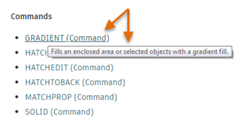

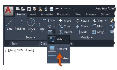

If you're not sure what a command does, hovering over the link displays a descriptive tooltip.

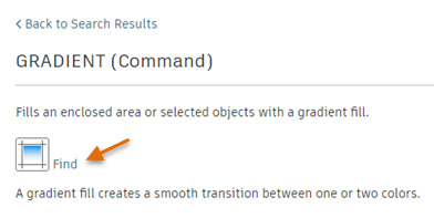

As a result, the ribbon opens to the correct tab and displays a bobbing arrow that displays the location of the command.

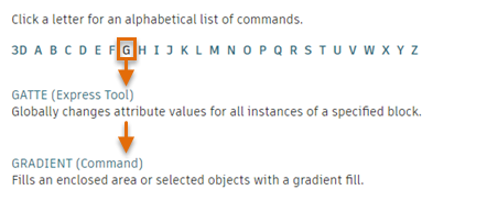

If you already know the command name, you can access it quickly in the Help Home page under Quick References. Follow these steps to access a command directly.
