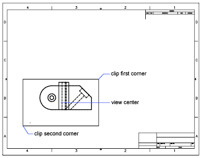

UCS
Creates a profile view relative to a user coordinate system. If no viewports exist in your drawing, the UCS option is a good way to create an initial viewport from which other views can be created. All other SOLVIEW options require an existing viewport.
You have the option of using the current UCS or a previously saved one as the profile plane. The viewport projection is created parallel to the XY plane of the UCS with the X axis facing right and the Y axis upward.
Named
Uses the XY plane of a named UCS to create a profile view.
Enter the name of the UCS you want to use and the scale of your view. Entering a scale is equivalent to zooming your viewport by a factor relative to paper space.
The center is based on the current model space extents.
World
Uses the XY plane of the WCS to create a profile view.
?—List Named UCSs
Lists the names of existing user coordinate systems. The list is filtered using the wild-card combinations you enter (wild-card characters accepted by the UCS command are valid).
Current
Uses the XY plane of the current UCS to create a profile view.

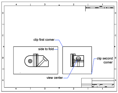

Ortho
Creates a folded orthographic view from an existing view.
Once you select the side of the viewport you want to use for projecting the new view, a rubber-band line perpendicular to the side of the viewport helps you locate the center of the new view.

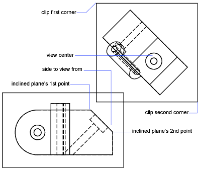

Auxiliary
Creates an auxiliary view from an existing view. An auxiliary view is one that is projected onto a plane perpendicular to one of the orthographic views and inclined in the adjacent view.
Two points define the inclined plane used for the auxiliary projection. Both points must be located in the same viewport.
A rubber-band line perpendicular to the inclined plane helps you select the center of the new viewport.
