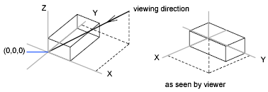

View Point
Creates a vector that defines a direction from which the drawing can be viewed. The view defined is as if the viewer is looking from the point back at the origin (0,0,0).

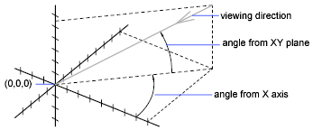

Rotate
Specifies a new viewing direction using two angles.
  • Enter angle in XY plane from X axis.
The first angle is specified with respect to the X axis, in the XY plane.
  • Enter angle from XY plane.
The second angle is specified up or down from the XY plane.
