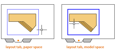

Switch between Model Space and Paper Space
When you're working on a layout tab, you can switch between paper space and model space without returning to the Model tab. Here's how. As shown in the illustration, you move your cursor and double-click either inside a layout viewport to access model space or you double-click outside the layout viewport to return to paper space. When you're in model space, the border of the layout viewport becomes thicker.
The primary reasons that you might want to access model space through the layout viewport is to pan the view or to make minor adjustments to the objects, especially those that display only in that viewport.
Tip: Instead of panning a view, simply select the viewport object from paper space, click one of the four size grips, and adjust the boundary.

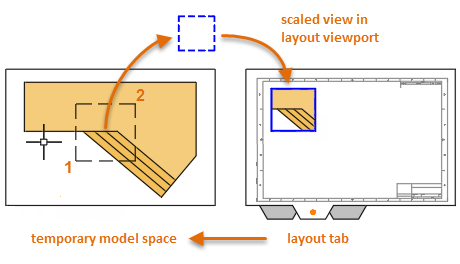

Create a New Viewport
You can use the New option of the MVIEW (make view) command to create additional layout viewports in paper space. With several layout viewports, you can display different views of model space at the same scale or at different scales.
  1. From a layout tab, enter MVIEW in the Command window and choose the New option.
  2. A maximized view of model space displays temporarily and you can click two points as shown to define an area.
  3. Back in the layout, right-click to display a list of scales and click the one that you want to use.
  4. Click a location to place the new layout viewport containing the scaled view.
If you later need to set a different scale, select the layout viewport and click the triangular scale grip. This action displays a list of scales to choose from.

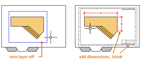

Trans-Spatial Annotation
After you create one or more scaled layout viewports on a layout tab, follow these steps to use the trans-spatial method of annotating your drawing:
  1. Move the layout viewport as needed, and adjust its edges using the size grips.
  2. Turn off the layer on which you created the layout viewport object. This hides the edges of the layout viewport.
  3. Create notes, labels, and dimensions directly in paper space. They automatically appear at the correct size.
  4. Print the drawing to paper or as a DWF or PDF file.
