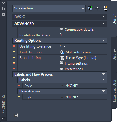

Properties on the Design tab of the Properties palette that you use to add pipe objects.
The Design tab is divided into two categories: Basic and Advanced.
Advanced properties are collapsed by default. To view advanced properties, click
(Down arrow).
Advanced properties shown expanded

| Routing options | Action | Selections |
*Use fitting tolerance |
Select Yes to turn deflection on at joints that have a tolerance angle specified in the content. This property controls the tolerance for the female fitting connection. Tip: Angle of deflection (AoD) is equally distributed between female connectors on a fitting that supports sloped piping. However, the value cannot exceed the stored angle of deflection value on the part. See Angle of Deflection ó Fitting Tolerance.
Note: If angle of deflection is unsupported, the software will disregard a Yes selection.
*Joint direction |
Select the orientation of fittings during layout. This property specifies how male and female joints are orientated as you draw pipe. For example, if you select Male into female, the male connector is drawn first and then the female connector is drawn after the joint. See Male-Female Fittings and Joint Direction. Tip: If you are drawing pipe in the direction of the flow, choose Male into Female. If you are drawing against the flow, choose Female out to Male.
*Branch fitting |
Select the fitting combination you want to use when adding a branch. If you select a double fitting combination (such as Tee or Wye), the software will use the first fitting, and if unsuccessful, will use the second. |
Fitting settings |
Click
*Preferences |
Click
| Labels | Action | Selections |
Style |
Specify the label style for the pipe run. |
| Flow arrows | Action | Selections |
Style |
Select the flow arrow style for the pipe run. |
