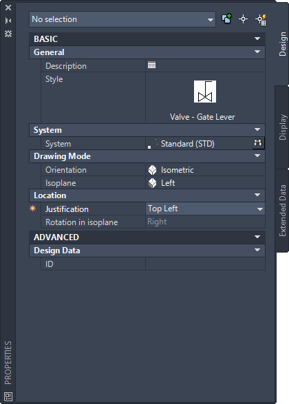

If necessary, scroll to display the tool. Because tools contain preconfigured properties for the objects they create, you might not need or be able to specify some of the schematic symbol properties referenced in this procedure.
| If you want to select a schematic symbol style… | then… |
| in the current drawing | in the Properties palette   Basic  General  Style   click the image. In the Styles Browser palette that displays, set the Drawing Source to Content Library Drawings File to Current Drawing.
| in a drawing in the directory specified as the default content location for schematic symbols | in the Properties palette   Basic  General  Style   click the image. In the Styles Browser palette that displays, set the Drawing File to Current Drawing.
				  Note: Not all schematic symbols provided with the software have isometric views. Drawings containing symbols with both orthographic and isometric views are named accordingly.
| in the style drawing referenced in the properties of a tool you selected | in the Properties palette   Basic  General  Style   click the image. In the Styles Browser palette that displays, set the Drawing Source to Currently Open Drawings, and Drawing File to All Drawings.
You can select either the insertion point of the view block that represents the symbol, or one of 9 other points on the device, such as Top Left or Middle Center.

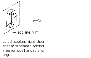

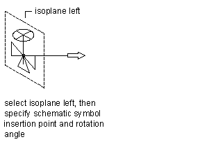

The UCS icon and crosshairs adjust to the selected isoplane.
Adding a schematic symbol to the left isoplane
Adding a schematic symbol to the top isoplane
Adding a schematic symbol to the right isoplane
