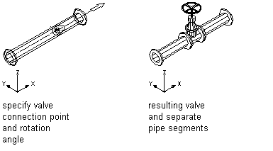

Adding a valve to a pipe segment

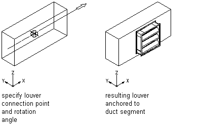

Adding a louver to a duct segment
