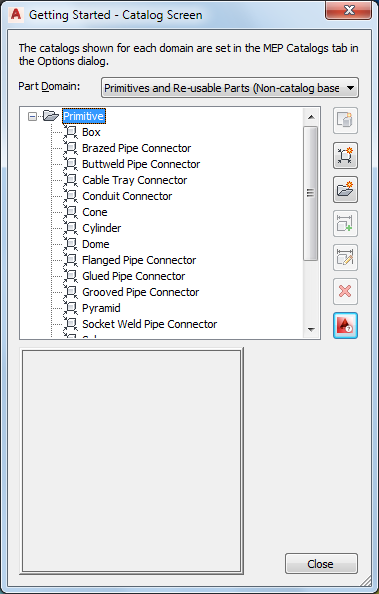

Content Builder .The Getting Started - Catalog Screen dialog box is displayed.
Getting Started - Catalog Screen dialog box for primitives
The Content Builder environment is displayed. Because primitives do not have many of the modeling features that parts have, such as part configuration information or size parameters, only a subset of modeling features are available to you.
