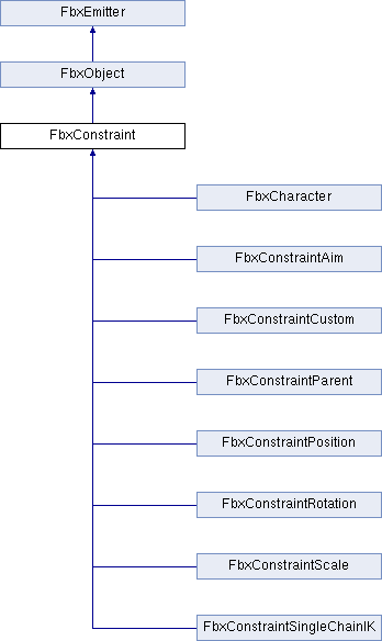

FBX C++ API Reference
FbxConstraint Class Reference
Base class for weighted animation constraints. More...
#include <fbxconstraint.h>
+ Inheritance diagram for FbxConstraint:
