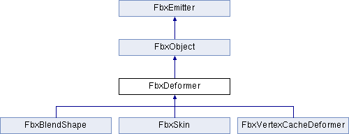

FBX C++ API Reference
FbxDeformer Class Reference
Base class for skin deformer (FbxSkin) and vertex cache deformer (FbxVertexCacheDeformer). More...
#include <fbxdeformer.h>
+ Inheritance diagram for FbxDeformer:

Detailed Description
The corresponding deformer types are FbxDeformer::eSkin and FbxDeformer::eVertexCache. A deformer can be binded to a geometry (FbxGeometry) to act on its shape. Typically, some objects under the deformer are animated, and via the deformer, the geometry is animated too.
A skin deformer contains clusters (FbxCluster). Each cluster acts on a subset of the geometry's control points, with different weights. For example, a mesh of humanoid shape can have a skin attached, that describes the way the humanoid mesh is deformed by bones. When the bones are animated, the clusters act on the geometry to animate it too.
A vertex cache deformer contains a cache (FbxCache). The cache contains animation information for every control point of the geometry.
Definition at line 38 of file fbxdeformer.h.
