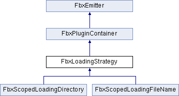

+ Inheritance diagram for FbxLoadingStrategy:

- Public Types inherited from FbxPluginContainer
typedef FbxIntrusiveList< FbxPlugin > PluginList
 Definition of a plug-in list. More...

- Public Member Functions inherited from FbxPluginContainer
void Register (FbxPlugin &pPlugin)
 The registration function that must be called when the module containing the plug-in is loaded. More...
void Unregister (FbxPlugin &pPlugin)
 The unregistration function that must be called when the module containing the plug-in is unloaded. More...
const PluginList & GetPlugins () const
 Const accessor to the list of plug-ins owned by the container. More...
 Accessor to the list of plug-ins owned by the container. More...
- Public Member Functions inherited from FbxEmitter
void AddListener (FbxEventHandler &pHandler)
 Add the specified event handler to current emitter list. More...
void RemoveListener (FbxEventHandler &pHandler)
 Remove the specified event handler from current emitter list. More...
template<typename EventType >
void Emit (const EventType &pEvent) const
 Emit an event with the specified the event type. More...
