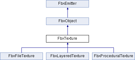

+ Inheritance diagram for FbxTexture:

Detailed Description
This class is the base class for textures, ie classes FbxFileTexture, FbxLayeredTexture and FbxProceduralTexture.
It describes image mapping on top of a geometry.
