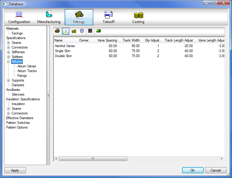

Access the air turn database settings by clicking Database
Fittings
Air Turns.

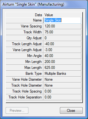

Double-clicking an entry in the table displays the following dialog for editing the air turn details. Clicking
creates a new air turn entry in the database.
The air turn options available in the database are:
Name: Specify a name for the air turn entry, for identification.
Vane Spacing: Lets you specify the distance between the vanes along the track.
Track Width: Lets you specify the width of the track onto which the Vanes are to be inserted. This is also used to aid in the calculation of the vanes by adjusting the calculated distance, based on how far the track can be pushed into the back of the bend. If vanes need to be calculated from the throat of the bend, all the way to the back, set this value to zero.
Qty Adjust: Can be used to add or subtract from the number of calculated vanes.
Track Length Adjust: This value is subtracted from the calculated length of the track. This may also affect the number of calculated vanes.
Vane Length Adjust: The vane length is calculated from the duct depth, minus the value entered into the Vane Length Adjust.
Min. Angle: Air turns will not be applied if the fitting is entered with an angle less than this value.
Min. Length: Refers to the minimum length of the Vane. If the calculated Vane length is below this value, then the air turn will not be applied to the fitting.

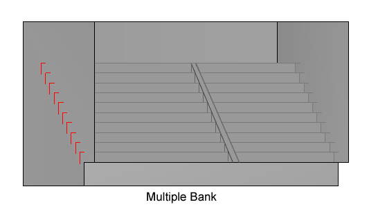

Max. Length: Refers to the maximum length of the Vane. If the calculated Vane length is above this value, and the "Bank Type" option is set to "Multiple Banks", the Vane length is calculated within the "Max. Length" value and the Airturn split into multiple banks accordingly.

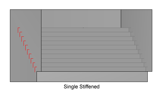

Bank Type: Can be set to either Multiple Banks or Single Stiffened. Multiple Banks will look at the depth of the duct and the Maximum Vane Length, and calculate the number of sets of air turns to fit.
Vane Hole Diameter : Specifies whether the vane connecting holes should be pierced, marked, omitted or specified with a value.
Track Hole Diameter: Specifies whether the track connecting holes should be pieced, marked, omitted or specified with a value. If the hole diameter is selected as pierced or a value, then the fitting cheek panels will be cut with the holes.
Track Hole Spacing: Specifies the distance between the track connector holes in the column for fixing to the duct.
Track Hole Separation: Specifies the distance between the two sets of track connecting holes.

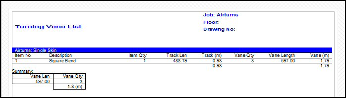

Printing Air Turn Reports: A print report can summarise the air turn material requirements and cutting list.
