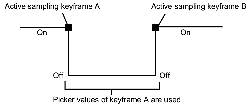

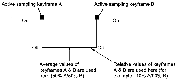

- Interpolation button
- Displays the interpolation between keyframes that have Active selected as the Sampling option.
- Linear (enabled): Picker values are interpolated between keyframes with active sampling. The picker values for each frame are computed based on the values of the previous and next active sampling keyframes and the proximity of the frame to those keyframes.
- Constant (disabled): Picker values are fixed between keyframes with active sampling. This means that the picker values at the first active sampling keyframe will be used for all subsequent frames up until the sampling is active again.
