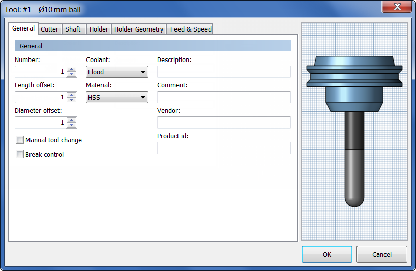

The New Mill Tool dialog box lets you edit an individual tool and is divided into six tabs:
The preview on the right side of the dialog displays the shape of the tool and is automatically updated to reflect any changes you make.
The number used to select the tool on the CNC machine.
The index of the tool length offset. This parameter is normally set when using tools with multiple tips indexed by length.
The index of the tool diameter offset.
Enable to force a manual tool change on machines with an automatic tool changer.
Enable to check for tool breakage after use.
The type of coolant used with the tool.
The tool material.
A textual description of the tool. This description is included in the tool name shown throughout Inventor CAM.
A text comment for the tool. The comment is typically included in the post-processed output.
The vendor of the tool. Use this to identify the specific tool used.
The vendor's identifier (ID) for the tool. Use this to identify the specific tool used.

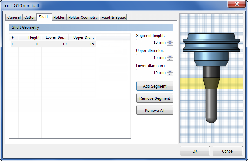

The tool flute length.
The tool shoulder length.
The tool body length.
Specifies the entire length of the tool.
The tool shaft/arbor diameter.
The pitch of the tap thread, specified as the vertical distance between the teeth of the tap.
The height of the selected tool shaft segment.
The upper diameter of the selected tool shaft segment.
The lower diameter of the selected tool shaft segment.

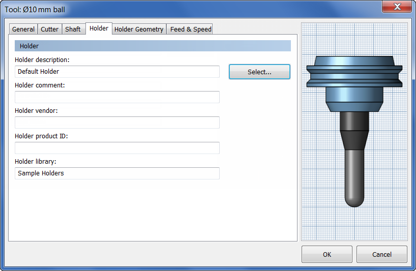

A textual description of the tool holder.
A text comment for the tool holder.
The vendor of the tool holder.
The vendor's identifier (ID) for the tool holder.
The library where the tool holder is stored.
