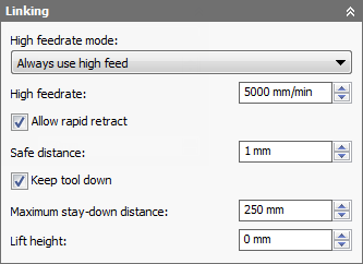

High feedrate
A yellow toolpath in preview and simulation indicate rapid movements and are output as G0, FMAX, or equivalent, depending on the post processor configuration.
You may occasionally prefer to use high feed movements rather than rapid movements. In these cases, you can set the High Feedrate Mode on the Linking tab.
Changing rapid movements to high feed movements at 5000mm/min
