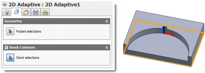

To machine an open 2D pocket using the 2D adaptive strategy, follow these steps:
2D Milling panel
2D Adaptive
to create a new 2D Adaptive Clearing operation.

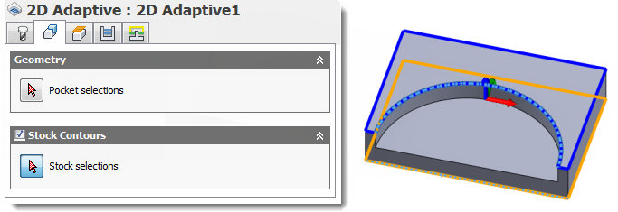

Selecting the stock contour
Selecting the contour with the open pocket
The toolpath should now look similar to that shown below:
