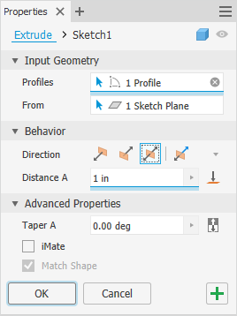

- On the ribbon, click
3D Model tab
Create panel
Extrude
If there is only one profile in the sketch, it is selected automatically. Otherwise, select a sketch profile.
- At the top of the property panel is the breadcrumb. To the right of the breadcrumb is the
feature type. The type determines the options presented in the property panel.
Specify the feature type you want to create:
Solid (default) - creates a solid feature from an open or closed profile.
Tip: Base features require a closed profile or region to create a solid.
Surface - creates a surface feature from an open or closed profile. It functions as a construction surface on which to terminate other features, or a split tool to create a split part, or split a part into multiple bodies. Surface selection is not available for assembly extrusions or primitives.
- Specify the
Input Geometry. You can use window select to quickly select multiple closed profiles within the same sketch.
Note: Use the
From and
To options to get the same result as the
Distance from Face and
Between methods used in prior releases.
Important: During feature preview visible sketch dimensions can be edited without entering the sketch environment.
- Profile(s) - the Profiles selector is active by default and when there are:
- One profile - if the sketch contains only one closed profile, it is automatically selected.
- Multiple profiles - select the profile or region that defines the desired extrusion or body.
Note: For part features, you can use a shared sketch as a profile.
To manually share a sketch:
- In the browser, click the plus sign beside the feature that contains the sketch you want to use to expose th sketch node.
- Right-click the sketch icon and click Share Sketch. Any sketch that you use in more than one feature is automatically shared.
- From - use this option to specify a workplane, face, or point from which to start the feature. If nothing is specified, the extrusion starts from the sketch plane.
Extend face to end feature - automatically activates when the
From selection does not intersect the extruded profile. You can also manually turn on or off the option.
Minimum Solution - when options for termination faces are ambiguous, specifies that the extrusion terminates on the closest face. With Minimum Solution selected, the extrusion terminates on the near side of the cylinder:
With Minimum Solution deselected, the extrusion terminates on the far side of the cylinder:
For assembly extrusions, selects a face or plane on which to terminate the extrusion. You can select faces and planes that reside on other components. The faces or planes that you select must reside on the same assembly level as the assembly extrusion that you are creating.
- Specify the
Behavior parameters, first choosing from the available options:
Direction: Default - Extrudes in one direction only. The extrusion end face is parallel to the sketch plane.
Flipped Direction - Extrudes in the direction opposite of Direction.
Symmetric - Extrudes in opposite directions from the sketch plane, using half the specified Distance A value in each direction.
Asymmetric - Extrudes in opposite directions from the sketch plane using two values, Distance A and Distance B. Enter a value for each distance. Click
to invert the extrude direction using the specified values.
- Distance A - specifies the depth of extrusion between start and end planes. For a base feature, shows negative or positive distance of extruded profile or entered value. Dragging the manipulator will modify the value.
- Distance B - specifies the depth in the secondary direction. Displays when Asymmetric is selected.
Through All - extrudes the profile through all features and sketches in the specified direction. Dragging the edge of the profile flips the extrusion to either side of the sketch plane. The Join operation is not available.
To - For part extrusions, selects an ending point, vertex, face, or plane on which to terminate the extrusion. For points and vertices, terminates the part feature on a plane parallel to the sketch plane which passes through the selected point or vertex. For faces or planes, terminates the part feature on the selected face, or on a face that extends beyond the termination plane. Click
Extend face to end feature to terminate the part feature on a face that extends beyond the termination plane.
For assembly extrusions, you can select sketch points, vertices, faces, and planes that reside on other components. To be selected, work planes and work points must reside on the same assembly level as the assembly extrusion you are creating.
To Next - (Not available for base features or assembly extrusions.) Selects the next possible face or plane on which to terminate the extrusion in the specified direction. Dragging the manipulator flips the extrusion to either side of sketch plane. Use the Terminator selector to select a solid or surface on which to terminate the extrusion and select a direction for the extrusion.
- In the
Output section specify the Boolean operation, choosing from:
Note: The Output section displays for non-base feature definition. If the feature is the part base (first) feature, Join is the only create operation available.
- In the Advanced Properties section you can specify additional options.
- Taper A - sets a taper angle from 0 to 180 degrees normal to the sketch plane. The taper extends equally in both directions.
A positive taper angle increases section area along the extrusion vector:
A negative taper angle decreases section area along the extrusion vector:
When used with adjacent regions, taper will merge and blend faces to create a single feature.
- iMate - Places an iMate on a closed loop such as an extruded cylinder, revolved feature, or hole. Autodesk Inventor attempts to place the iMate on the closed loop most likely to be useful. In most cases, place only one or two iMates per part.
- Match Shape - If you select an open profile in a part file, specify whether you want to Match Shape and, if so, select the side to keep.
If selected, Match Shape creates a flood-fill type operation. The open ends of the profile extend to a coedge, or face. The required faces quilt together to form a complete intersection with the extruded body.
When deselected, the open profile closes by extending the open ends of the profile to the part. It closes the gap between them by including edges defined by the intersection of the sketch plane and the part. Creates the extrusion as if you specified a closed profile.
- Click OK or
(Create new feature) to continue defining revolved features.
