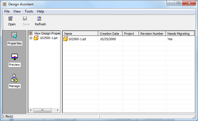

1. Data Migration Preparation
Files in Design Assistant can be opened directly in Inventor.
