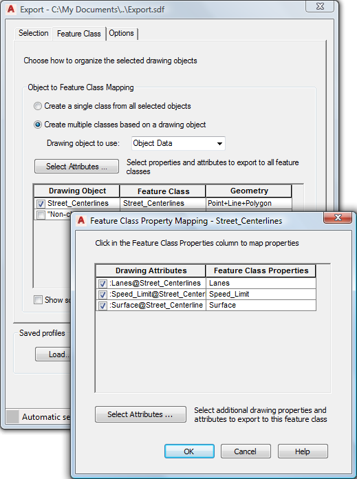

  4. In the Export dialog box, on the Selection tab, make sure Select All is selected.
  5. Click the Feature Class tab, and do the following:
    • Click Create Multiple Classes Based On A Drawing Object.
    • For Drawing Object To Use, select Object Data.
    • Under Drawing Object, clear the Non-Classified check box.
    • Under Feature Class, click Street_Centerlines.
    • Click the browse button that appears in the field.
    The object data for Street_Centerlines has three attributes: Lanes, Speed_Limit, and Surface.
  6. In the Feature Class Mapping dialog box, do the following:
    • Click Select Attributes.
    • Expand the Object Data item to see the attributes that will become properties of the new feature class.
    • Click OK twice to return to the Export dialog box.
  7. Click OK to export the drawing objects to the SDF file.
