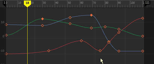

A graphical representation of interpolation between animation keys that you can modify.
To open the Graph Editor:
Maya's Graph Editor is an updated version of the legacy Maya Graph Editor, giving you a more intuitive approach to manipulating animation curves and keys in your scene.
The following table provides a brief overview of tasks using the Graph Editor:
| To... | Do this |
Place the Graph Editor in a scene view |
Select the scene view in which you want the Graph Editor to appear, then select . |
Select a key |
Click the key or drag-select it.
![]() Tip: You have to click
directly on the key. Zoom in (Alt + drag) to increase precision. If you can't select a key this way, it may be a graphics card issue; make sure you have the most up to date drivers.

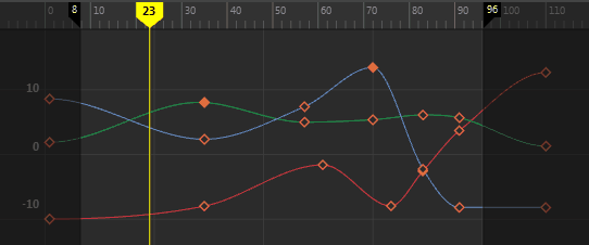

| Resize the Playback range | On the Time Ruler, click the edge of the dark region and drag to change the playback range. Stretch the playback range in the time view by dragging the flags on the Time ruler.
| Scrub animation | Drag the Current Time Marker.

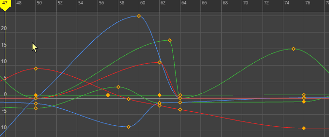

| Move multiple keyframes in time without changing the attribute value | Drag-select the keyframes to move. Shift-middle-drag the frames left or right.
