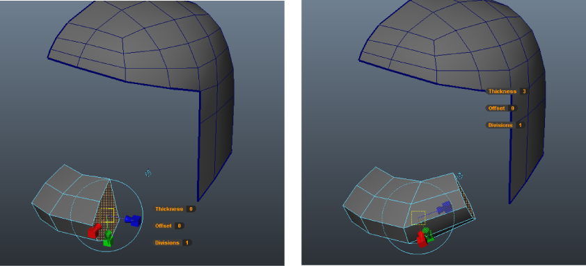

To extrude the polygon face for the lower front region
- Enlarge the scene view to a single perspective view.
- With the polygon face still selected, choose
Extrude in the Modeling Toolkit.
The extrude manipulator appears on the selected face.
- In the perspective view, enter a value of 1.5 into the
Thickness field to extrude a section of mesh:
- Press the g key (repeats last action) to extrude again.
- Enter a value of 2.0 in the
Thickness field.

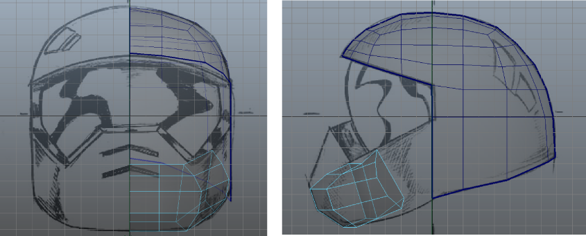

- Click the large blue circle that surrounds the manipulator to display the rotate manipulators and then drag the green circular manipulator to rotate the angle of the extrusion to match the angle in the reference sketch (see image). You can also open the
Channel Box and set
Local Rotate Y to -26.
- Press the g key once again to create a third extruded region.
- Enter a value of 3.0 in the
Thickness field.
- Enter the following values in the
Channel Box to adjust the angle of the extrusion:
- Local Rotate X: 12
- Local Rotate Y: -30
- Local Rotate Z: 16
- Local Scale X: 0.5
- Local Scale Y: 1
- Local Scale Z: 1.3
- You may also want to view the extrusion from either the front or side view to ensure your extrusion doesn’t extend outwards more than the side region.
- Save your work.

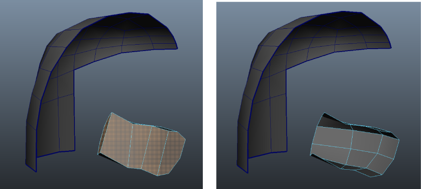

To delete unwanted faces on the extruded mesh
- Tumble the perspective view until you can view the inside of the lower front region (see image below).
- Select the faces that appear on the inside of the mesh you just extruded, including the faces on either end of the extrusion.
These faces were required for creating the extruded portions of the lower region but are not needed beyond this point.
- Press the Delete key to delete the selected faces.
When you are finished, a gap will exist between the last extruded segment of the lower region and the helmet mesh.
You’ll combine these separate meshes together and then create a mesh that bridges between them in the next section of the lesson. To prepare for the bridge, you need to extrude more edges on the helmet mesh so that the number of edges match when you create the bridge.

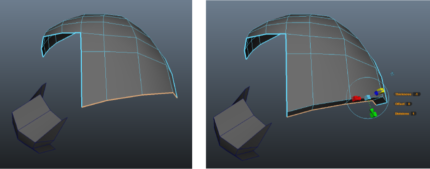

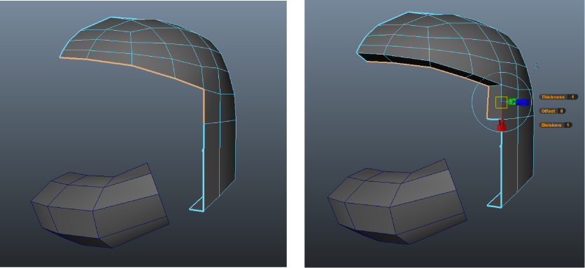

To extrude the bottom edges of the helmet mesh
- In the perspective view, select the lower edges of the helmet mesh using Shift + Double-click.
- In the Modeling Toolkit, select Extrude, then enter a value of -1.0 in the
Thickness field that appears.
To extrude top and side edges for the face shield
- In the perspective view, select the upper and side edges on the helmet mesh using Shift + Double-Click (see image below).
- In the Modeling Toolkit, select Extrude and then enter a value of -1.0 in the

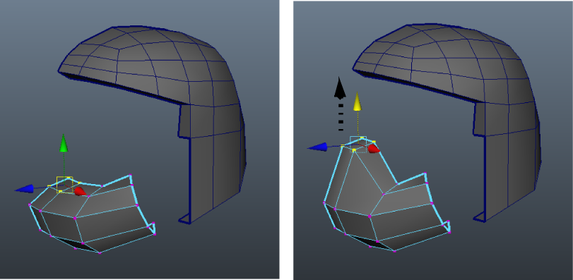

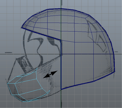

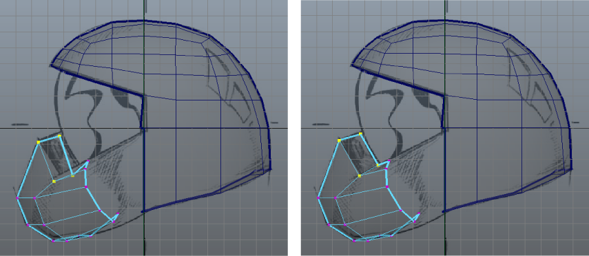

To move vertices on the lower front region to match the reference sketch
- In the perspective view, right-click on the helmet and select vertex mode to change the selection type to vertices.
- Select the four vertices on the lower front region of the helmet that are near the axis of symmetry (see image below) and using the
Move Tool, move the selected vertices upwards by dragging the green arrow on the
Move Tool manipulator so that the lower front region of the helmet matches the reference sketches as they appear in the various orthographic views.
- Adjust any vertices on the lower region that may require minor repositioning by selecting and moving them as necessary.
