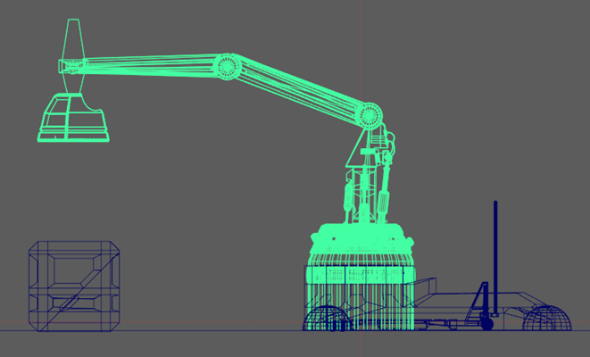

    In the next steps, SwivelBase becomes the parent node for the new hierarchy so that the entire arm assembly swivels about the center of the base component.
  4. In the Outliner, select the node named joint1 and then Control-select the node named SwivelBase.
  5. In the main menu, select Edit > Parent (Hotkey p).
  6. In the Outliner, select the node named SwivelBase.
    In the side view, observe that both the mechanical arm model and the skeleton are selected.
    SwivelBase is the parent or root node for the hierarchy. If you rotate SwivelBase, everything else below that node (the entire arm with skeleton) rotates.
  7. Select the node named joint3.
    Observe that the last two components of the mechanical arm are selected. If you rotate joint3, only the components below that node in the hierarchy will be affected.
  8. Select the node named pin2.
    Observe that only one isolated segment of the model is selected. No other components or joints are selected when the pin2 node is selected. If you rotate the model at pin2, only the component at pin2 will rotate in isolation from the rest of the hierarchy because it is located lower in the hierarchy.
