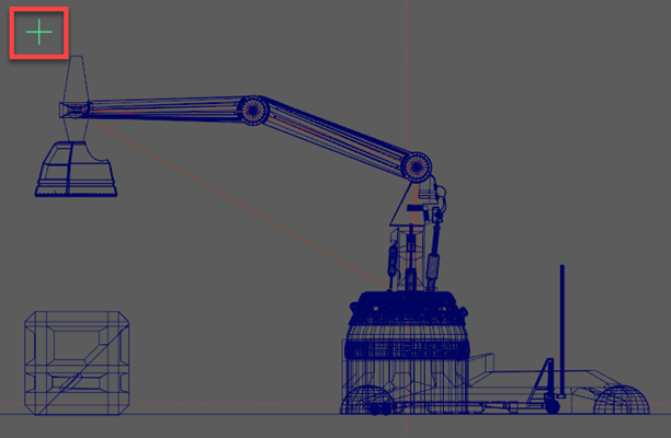

  3. In the side view, reposition the locator slightly above and in front of the end of the mechanical arm as shown in the image below.
