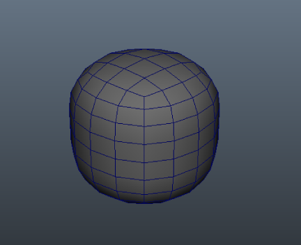

To display the helmet mesh in Wireframe on Shaded mode
  1. In the perspective view, right-click on the helmet mesh and select Object Mode from the marking menu that appears.
    This changes the selection mode to Objects.
  2. Select the helmet mesh.
  3. In the perspective view, select Shading > Smooth Shade All from the panel menu.
    The helmet mesh displays in smooth shaded mode.
  4. From the panel menu, select Shading > Wireframe on Shaded.
    The wireframe appears on the mesh as well as the shading (whether or not the mesh is selected).

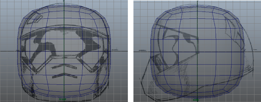

The opacity of the smooth shading in the side and front views prevents you from seeing the image planes behind the object. X-Ray display mode solves this problem by making the smooth shaded surface appear semitransparent.
To display the helmet mesh in shaded X-Ray mode
  1. With the helmet still selected, choose the following from the side view’s panel menu:
    • Shading > Smooth Shade All
    • Shading > Wireframe on Shaded
    • Shading > X-Ray.
    The helmet mesh updates to a semitransparent shaded display with the wireframe. You can see the 2D image behind the mesh.
  2. Repeat the previous step for the front view as well.
    After setting the shading for the objects in the various views, you may wish to adjust the Alpha Gain setting on your image planes to change their transparency.
