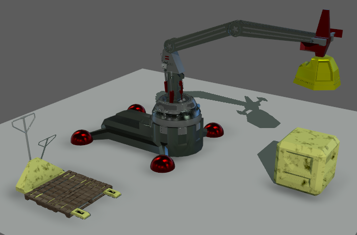

    The scene contains a model of a mechanical arm and a cargo box to be moved by the arm. The components of the mechanical arm include:
    • A cargo magnet cup on the end
    • Three arm segments
    • A base for the arm to swivel about
    • A four-legged base for the assembly
To work with this model using IK you must create a hierarchy for it.
