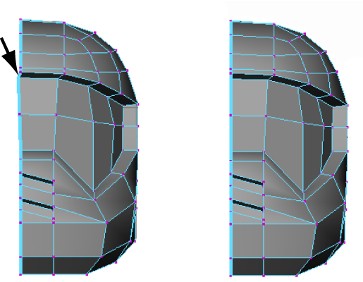

Before copying one half across the axis of symmetry, you should check that all of the border edges lie along the axis of symmetry. If any edges do not lie along this axis, the original half will be copied based on the vertices that create the widest point and a gap between the two halves may result.
To ensure that the border vertices lie along the axis of symmetry
  1. Enlarge the front view so you can view the vertices that lie along the axis of symmetry.
    If any vertices on the mesh protrude across the Y-axis, you’ll need to snap these to the Y-axis using the Move Tool in combination with the Snap to grids feature.
    Note:
    Any vertices that protrude across the Y-axis likely occurred as a result of an earlier extrude operation. Because the extrude feature extrudes components based on the face normal, a few vertices may have moved across the axis of symmetry.
  2. In the front view, select all of the vertices that should lie along the axis of symmetry (Y-axis) using a bounding box selection.
  3. On the Status Line, turn on Snap to Grids.
  4. In the Toolbox, double-click the Move Tool to display its tool settings and ensure that the Retain component spacing setting is turned off.
  5. In the front view, drag the red arrow on the Move Tool manipulator to the right a small distance.
    The vertices immediately snap to the grid line to the right. They initially will not be positioned at the location you want, but you’ll notice that all of the vertices you selected are now aligned to each other.
  6. Drag the manipulator towards the left until the vertices snap to the Y-axis.
  7. On the Status Line, turn off Snap to Grids.
  8. Click off the mesh to unselect the vertices.

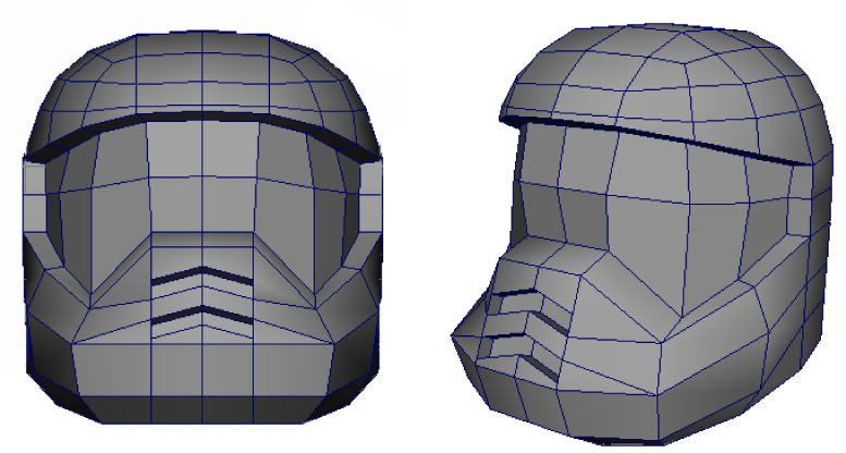

  1. Right-click the mesh, change the selection mode to Object Mode, and then select the helmet mesh.
  2. Select Mesh > Mirror >, set the following options, and then click the Mirror button.
    • Mirror Direction: -X
    • Combine with Original: On
    • Border: Merge border vertices: On
    The mesh is copied along -X to create the opposite half of the model. The two meshes are combined into one and vertices are merged so they become shared.
  3. Save your work before proceeding to the next section.
At this point, the low resolution version of the helmet model is complete. In the next section you’ll preview how the model appears at a higher resolution using the Subdiv Proxy feature.
