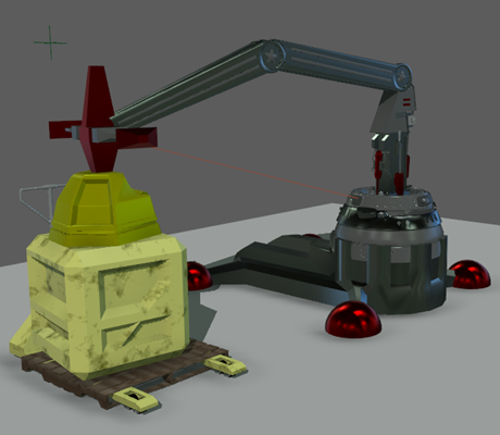

The arm is repositioned so that the cargo magnet is directly above the cargo box as shown below. Track, tumble, or dolly the view if required so you can see the mechanical arm unobstructed.
  1. In the Outliner, with ArmControl still selected, Control-select the CargoBox node.
    The order of selection is important when you apply constraints. You must select the constraining object first, and the item to be constrained second.
  2. In the main menu, select Constrain > Parent > .
  3. In the Parent Constraint Options window, do the following:
    • Select Edit > Reset Settings to set the tool to its default settings.
    • Click the Add button.
    CargoBox is constrained to ControlArm. A new constraint node has been created below the CargoBox node in the Outliner. If you reposition the mechanical arm, CargoBox moves with it because of the constraint that is now applied.

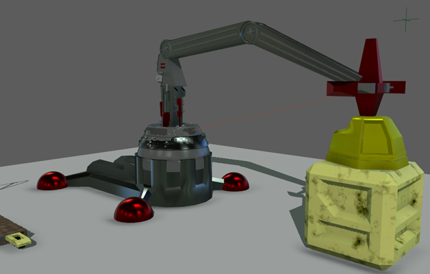

  4. In the Outliner, select only SwivelBase.
  5. In the Channel Box, set the Rotate Y value for SwivelBase as follows:
    • Rotate Y: -100
    The mechanical arm and the cargo box are positioned as shown below.
  6. In the Outliner, select Platform and then Control-select the CargoBox node.
  7. In the main menu, select Constrain > Parent.
    CargoBox is constrained to Platform. This is the second constraint for the CargoBox.

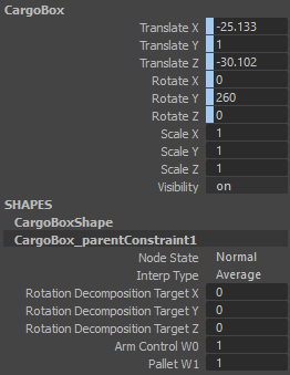

  8. In the Outliner, select only CargoBox.
  9. In the Channel Box, view the parent constraints for CargoBox.
    CargoBox has two parent constraints applied to it: Arm Control and Platform. In the Channel Box, the numerical settings beside ArmControl W0 and Platform W1 represent the influence weight each parent constraint has on CargoBox. At this point, each influence weight is set to a value of 1. If you move the mechanical arm, the cargo box will move somewhere between its first and second position. This occurs because each constraint has equal influence on the cargo box at this point.
