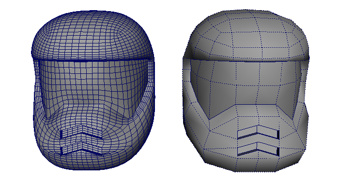

To soften the edges on the mesh
  1. With the low resolution version of the helmet still selected, select Mesh Display > Soften Edge.
All of the edges on the helmet mesh are set to be shaded in a softened fashion. The wireframe mesh updates to display as dashed lines indicating that all of the edges are set to be soft shaded. You may not notice any immediate effect on the smoothed high resolution version, but its important that you perform this step before you proceed to harden specific edges on this model.

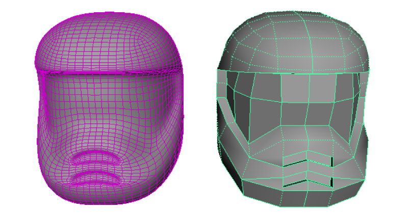

To harden the edges surrounding the face shield
  1. Right-click the low resolution mesh and set the selection mode to Edge.
  2. Select the inner edges that surround the perimeter of the face shield (see image below).
  3. Select Mesh Display > Harden Edge.
    The selected edges are hardened on the low resolution mesh.

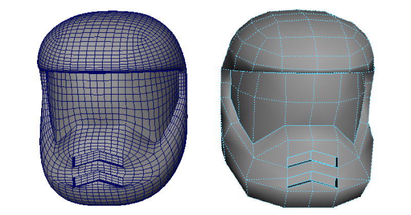

    Notice that the same edges on the smoothed high resolution version of the helmet are unchanged. For edges to display sharp on the smoothed version, you must turn on the Keep Hard Edge attribute.
To turn on the Keep Hard Edge attribute
  1. In the perspective view, select only the smoothed high resolution version of the helmet mesh.
  2. In the Channel Box, in the Inputs section, click the listed proxy to display its attributes.
  3. Set the Keep Hard Edge attribute to On.
    The sharper transition between the face shield and the rest of the helmet now appears on the smoothed high resolution version.
  4. Select all of the edges for the grill vents and harden them as well.

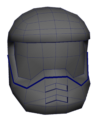

To crease edges on the mesh
  1. Select the lower outer edges on the face shield (see image).
  2. Select Mesh Tools > Crease Tool.
  3. In the scene view, press the middle mouse button then drag the mouse to the right to add a crease to the selected edges.
    A thick line appears on the low resolution model to indicate that a crease has been applied.
  4. Save your work.
    Note:
    You can toggle the creased edge display (thick lines) by selecting Display > Polygons > Crease Edges.
