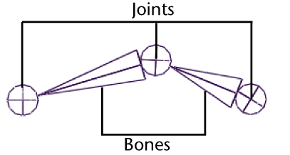

To link the various components of the mechanical arm into a hierarchy that can be posed, you need to create a skeleton. A skeleton is a hierarchy of joints that are connected together with bones.
In the scene, a joint represents a special type of node that gets created in a skeleton hierarchy. A joint acts as the parent node for any other joints that occur in the hierarchy below it. Each joint has a rotational pivot point associated with it. A bone is the visual representation used in the scene view to connect the joints and help visualize the joint chain.

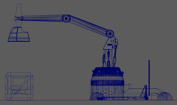

  1. In the perspective view menu, select Panels > Orthographic > side.
    The view updates to display the side view.
    You need to view the components of the mechanical arm fully in the side view so you can draw the joints for the skeleton.
  2. Resize the side view to a larger size by dragging the border between the side and Hypergraph panel views downwards.
  3. In the side view menu, select Shading > Wireframe (Hotkey 4).

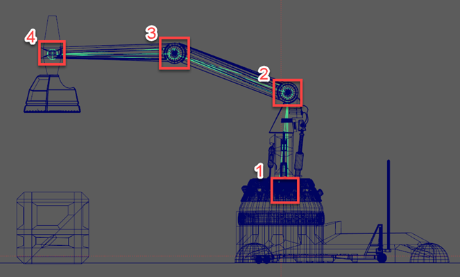

  6. In the side view, starting from the base of the mechanical arm, do the following:
    • Click in the center of each pivot pin on the mechanical arm to place four joints as shown in the image below.
    Try to click as close to the center of each pivot pin as you can, as the rotation of the joints on the model will be based on the location of the joints on the skeleton. As you place the joints, a bone appears, connecting each joint. (Because the model lies along the YZ plane, the joints are created close to the center of each corresponding joint on the mechanical arm model.)
    • After you place the fourth joint, press Enter to indicate that the last joint has been placed.
